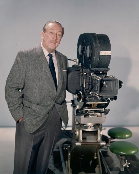

Heck Mr. Pebbles, I have no idea. But great topic and I hope somebody more knowledgeable will respond. In the meantime, will you settle for a photo of Walt Disney and a Mitchell BNC? It's in living color. Get it? Wonderful world of .... ah never mind.

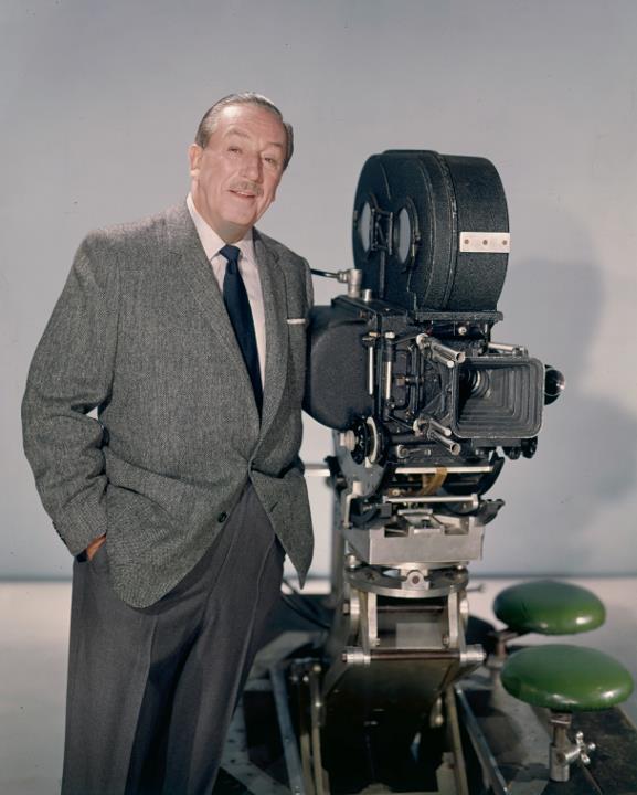

Love the color shot of BOTH Walt and the BNC. I don't know the answer to the question either and I don't even have a nice color photo to share. But I do have this fine B&W one, if you will accept it. Walt is looking rather dapper and I like the tape measure hanging down from the camera. Now that is a real action shot! If you don't see a tape measure than something is wrong/stagged. I also like the sun shade on the external viewfinder.
But back to the Multiplane camera make - I have no idea. So sorry.
Now back to pulling some focus ...
