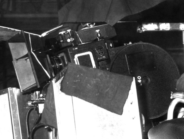

This forum has talked about many types of Mitchell cameras but I have not seen anything about their "Elephant Ear" camera. This was the nickname for the Mitchell VistaVision camera. For those of you who are not familiar with it, the Paramount Camera department, apparently working with Technicolor, came up with their own film format during the Widescreen movie battle of the 1950's. This is the camera they came up with. Because it's large 2000 ft. magazines were large and drooped down below the bottom of the camera, it was likened to an elephant ear. This format used regular 35mm film but exposed it horizontally rather than vertically, just like a 35mm still film camera. This created a bigger picture and the final release print looked better and could be printed in different formats. The downside was it exposed twice as much film, which is why they made a 2000 ft. magazine instead of the standard 1000 ft., which would give you the same amount of shooting time.
As to my investigation, I was trying to find history on a particular VistaVision camera. Mitchell had only made 32 cameras and they were only used in the mid 1950s to the mid 1960s (until Lucas Film re-found the format, but that's another story). I traveled to the Los Angeles area library that I previously mentioned and randomly looked through various VistaVision movie photographs. What I was looking for the usual behind the scenes shots that would show the blimps. Paramount would paint the camera number on the outside of the blimp, as they had done years earlier. Although there is some evidence that this may not always guarantee that the numbers matched.
I ran across a photo that showed a camera outside the blimp. But of course you can not see the serial number on their acorn ID tag. However, Paramount gave an inventory number to all their equipment. All the numbers I have seen begin with a "C" and then an ever increasing number. through magnification I was able to read that number, painted in white, just below the ID tag.
I did not have that number when I was looking through the photos as I did not even expect to see it. Upon later examining the camera I could just barely see that there even was a number painted on the camera, but no way could read it. I then examined the rest of the camera and found a "C" number stamped into the metal body of the camera. I compared that number to the number in the photo and Bingo! It was a match. I could now say that the Mitchell VistaVision had worked on the Court Jester, staring Danny Kaye! So as I said, it is really an investigation, and a lot of work BUT a lot of fun at the same time.

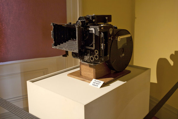

Here is a picture of MVV-7 on short term display at the old San Francisco Mint building. They were showcasing San Francisco in the Movies! They had a room devoted to Vertigo and of course this camera was in that room.
