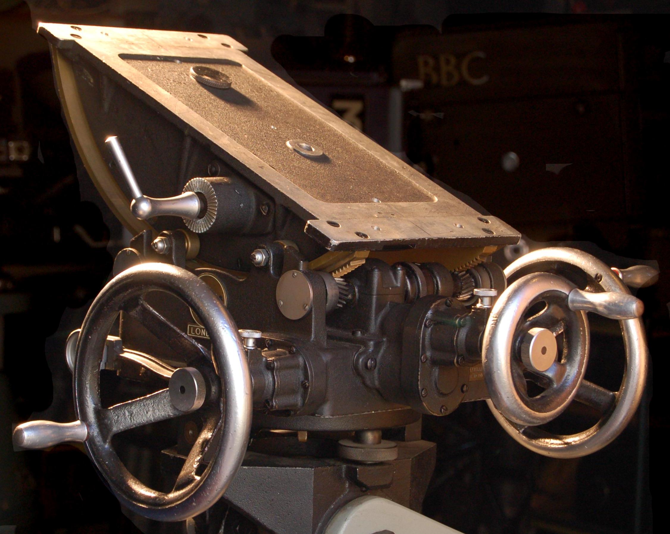

I found a worrall motion controlled head and am re installing the handwheels traditionally.
Now upon removing the tilt gearbox flat coverplate it revealed a missing identical gear cluster..
I need to stop the entire world from panning and tilting to locate a 2 speed gear cluster please..

Re: Best Mitchell Geared Head - Worrall of course!
Post by Matt Way » Thu May 09, 2019 11:13 pm
I tried calling the number and it had been disconnected.
Might anyone know who may have a 2 speed gear cluster ?? Or a current contact for Grandson of Worrall ?? Or any updated on possible part or makers ?

Posts: 148
Post by mediaed » Fri May 10, 2019 10:31 am
Congrats on joining the Worrell world.
Luckily you live in the LA area. If you can pull the other gear set, there should be a number of area machinest shops capable of making matching replacements from scratch. You might need to shop around. You could even find someone who can take it apart and pit it back together. Ken Stone is another resource.
Was this the one Steve Kramms was selling? Best. ED.

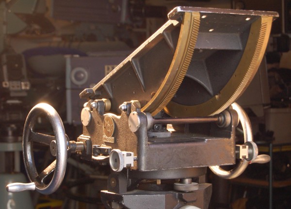

Post by lilybettina1 » Fri May 17, 2019 4:39 am
This is my 'lesser' Moy geared head. I thought that Raby made the 'Sputnik' pump up tripod unit?
