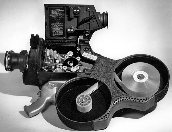

mark II blimp 5.jpg (94.49 KiB) Viewed 33715 times
This layout photo from the Swedish Film Institute shows the features that make this possible with the R-35 - the pistol grip, the revised vertical stepped magazine that also acts as a shoulder rest, thumb lug, and the (not shown here) lens turret arrangement - all geared to this end.
The hand-held aspect of the design is taken so far that for tripod mounting, it is pointed out with an asterisk, an accessory adapter is required. Of course, because it's meant to be a hand-held camera.
