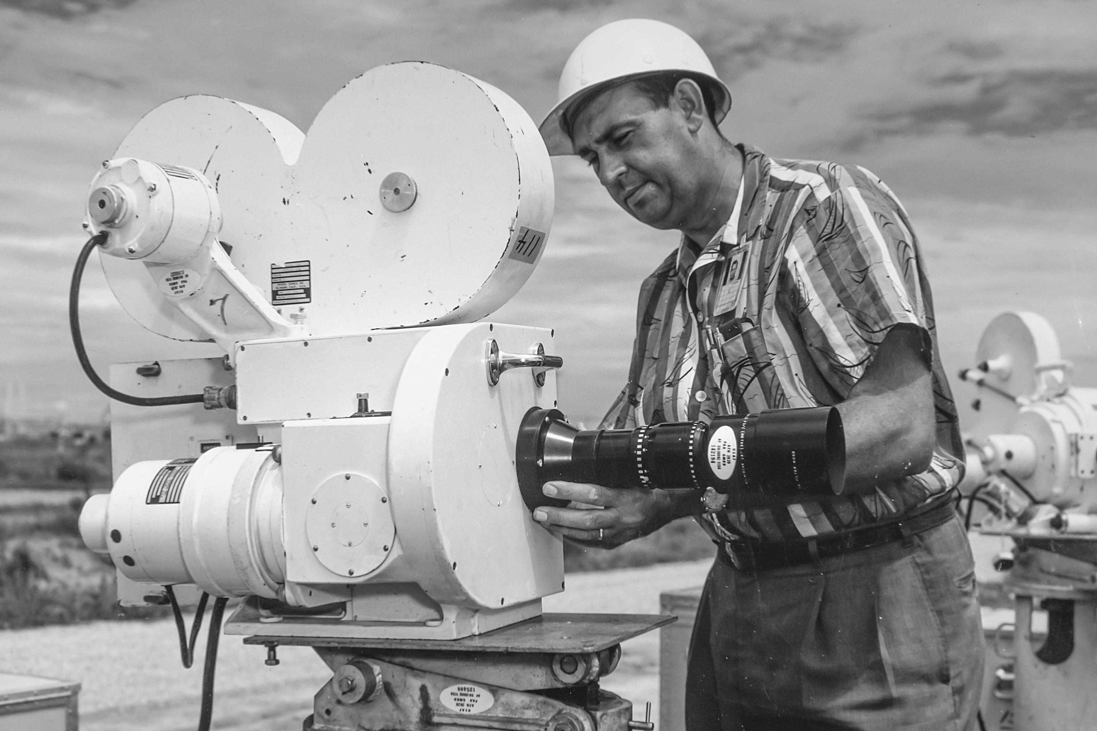

There were numerous Mitchell cameras at work every day. This included Mitchell 16’s, 35mm GC’s, and a number of 65mm cameras. All models were painted white to deal with the tremendous heat of the Florida sun.

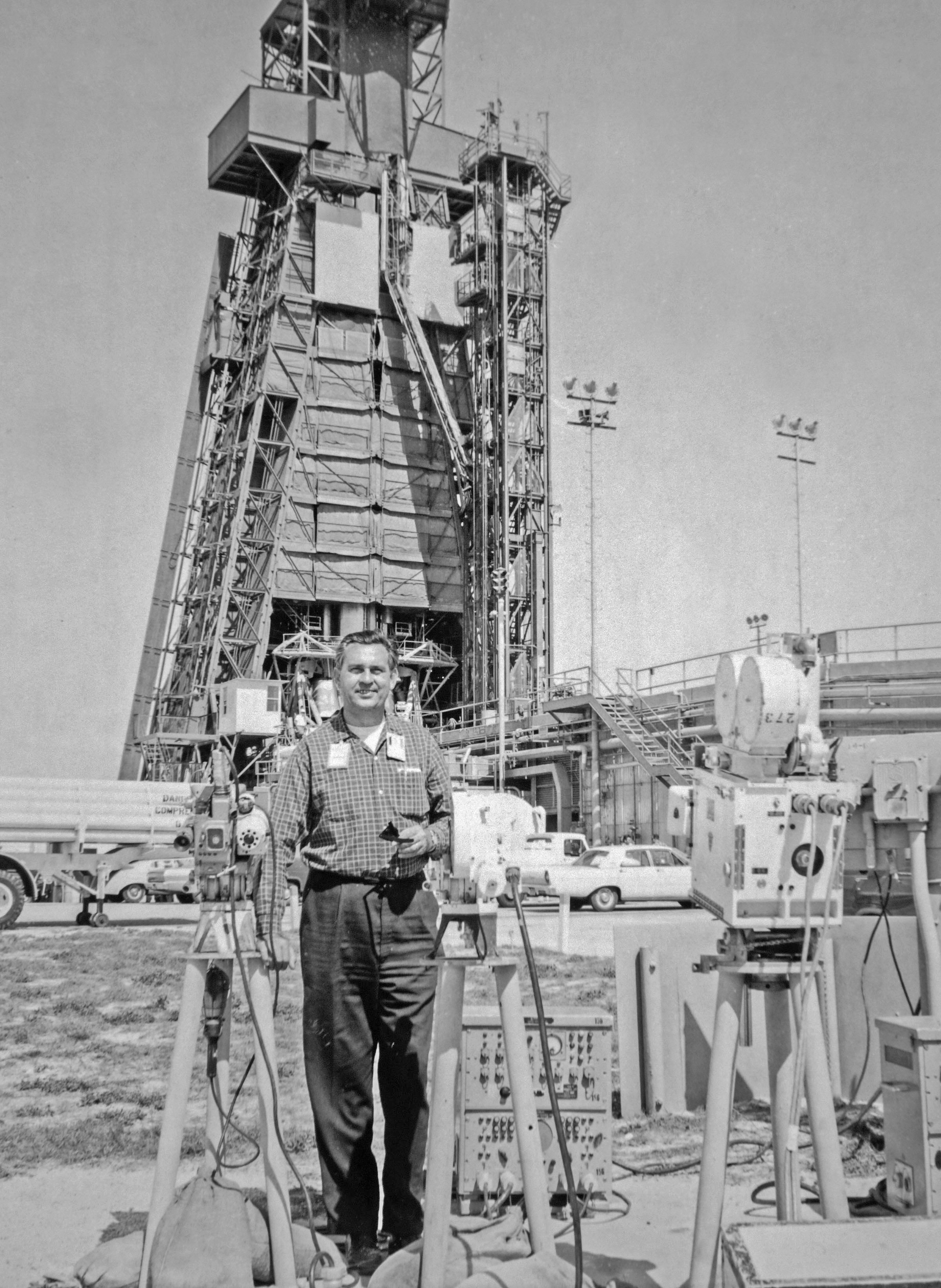

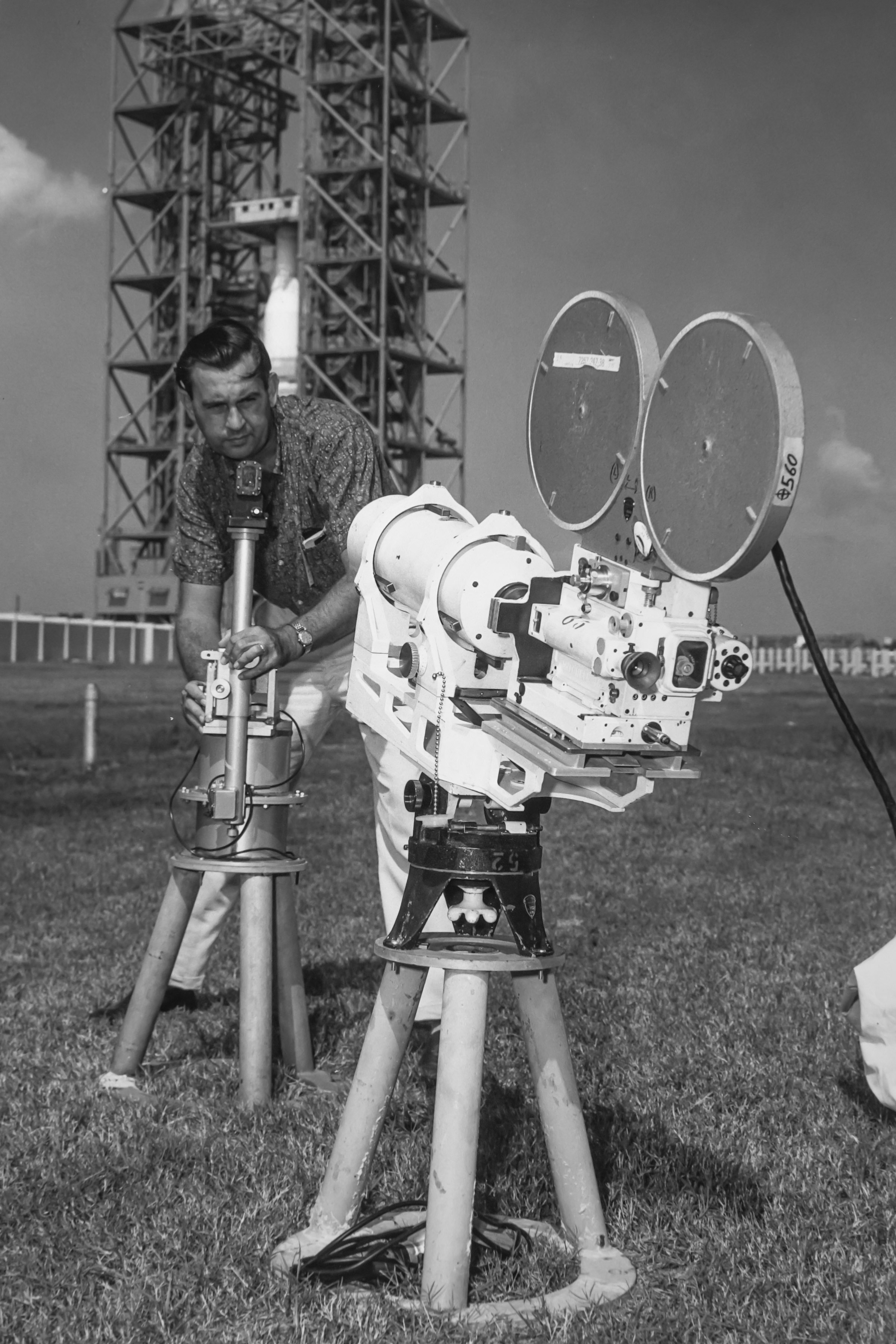

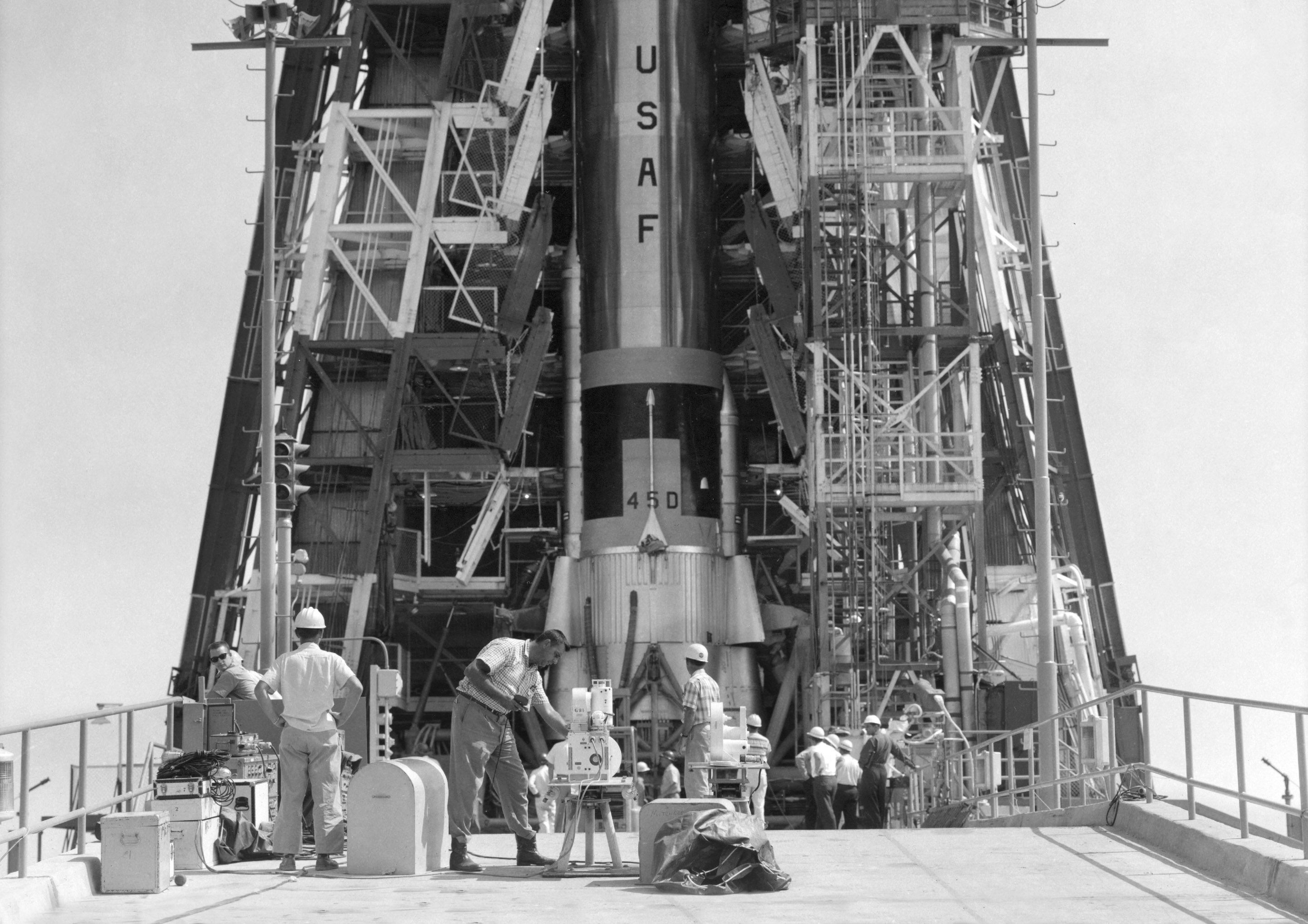

My dad loads a 65mm Mitchell at Cape Canaveral

a 65mm Mitchell is placed close to an Atlas
a 16mm Mitchell is aligned with an optical data system

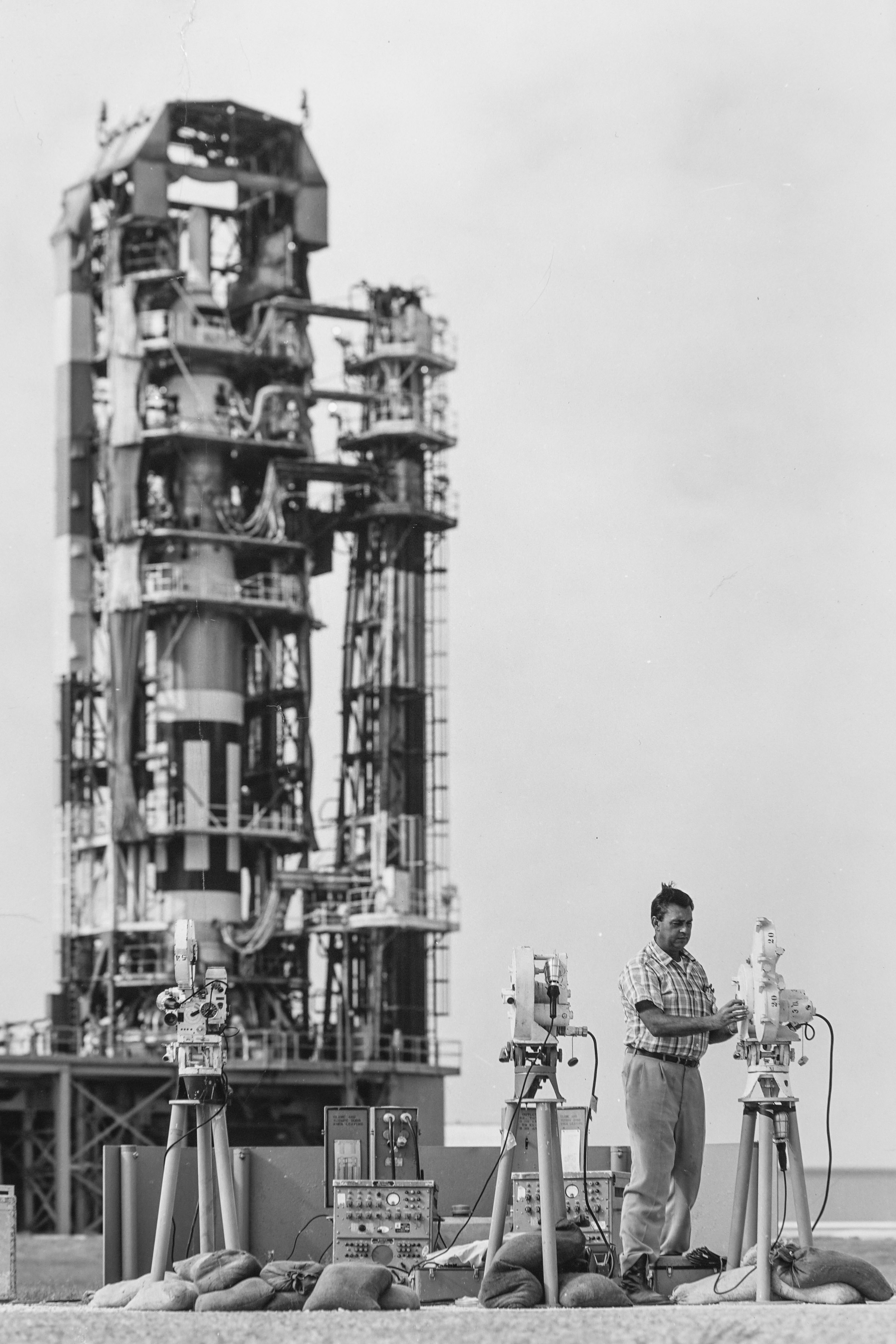

My dad sets up 3 cameras for a Titan launch

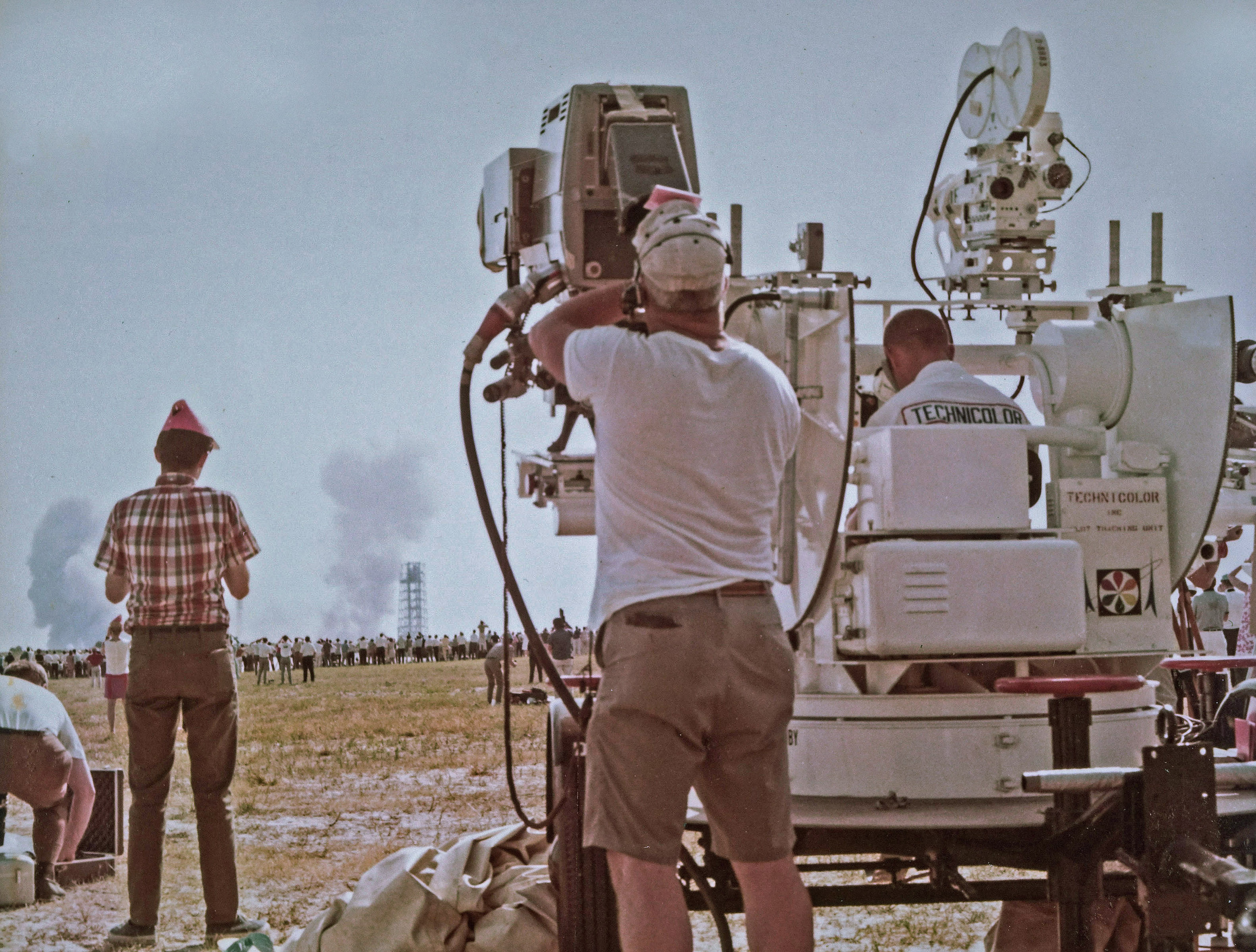

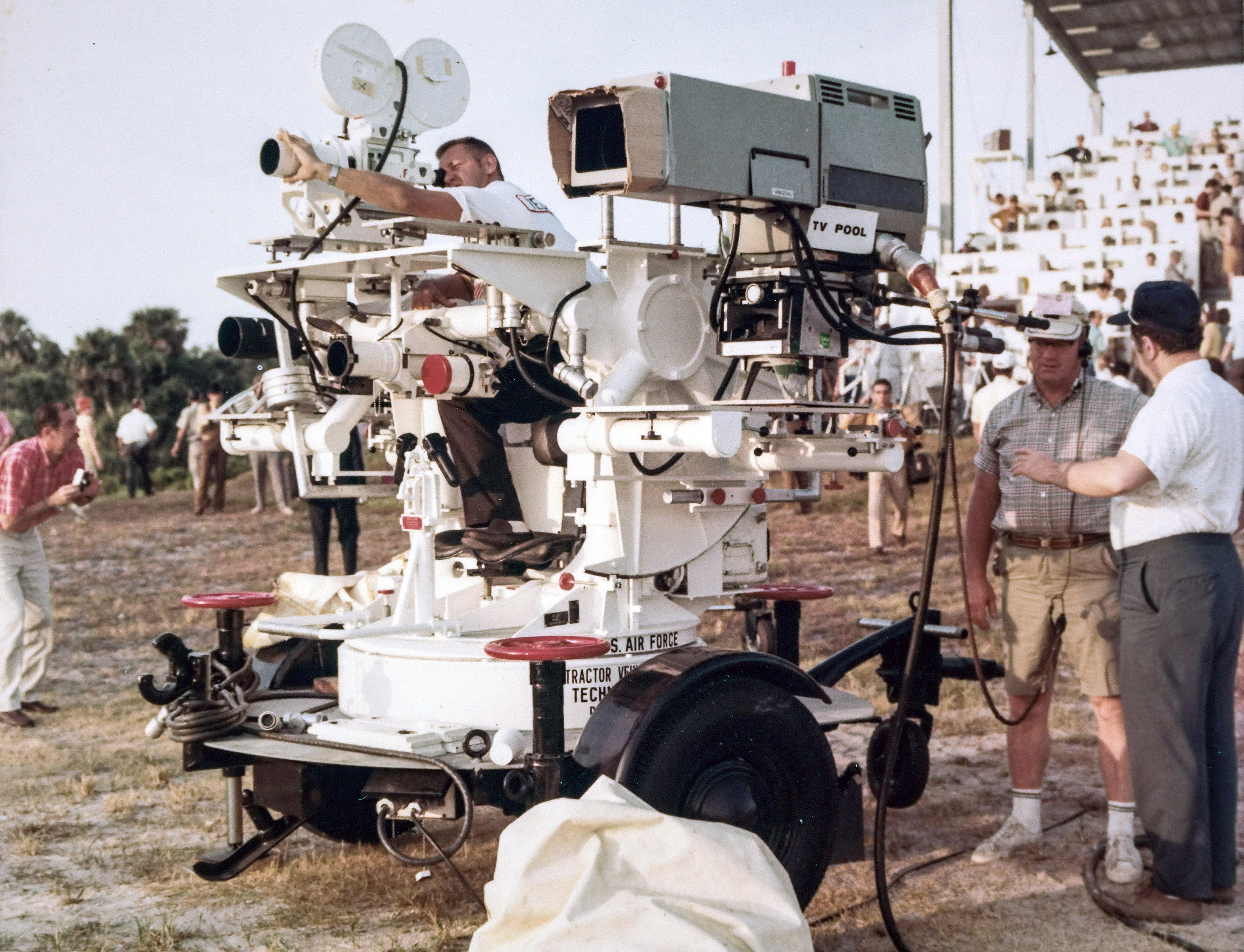

During the Apollo 11 launch the same tracking mount handled a Norelco PC70 & a 35mm Mitchell
The world watched the live color camera, but the best images were from the Mitchell 35

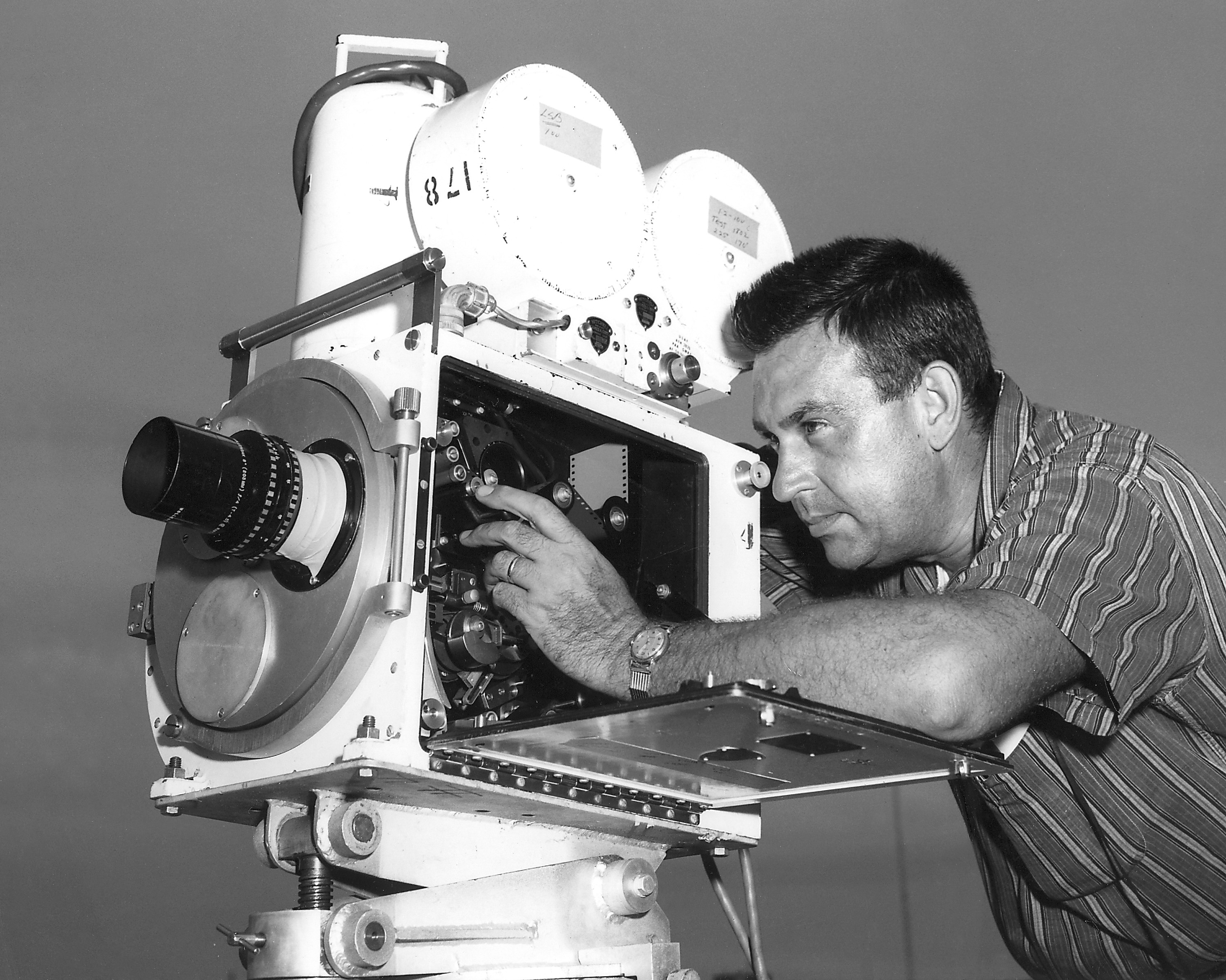

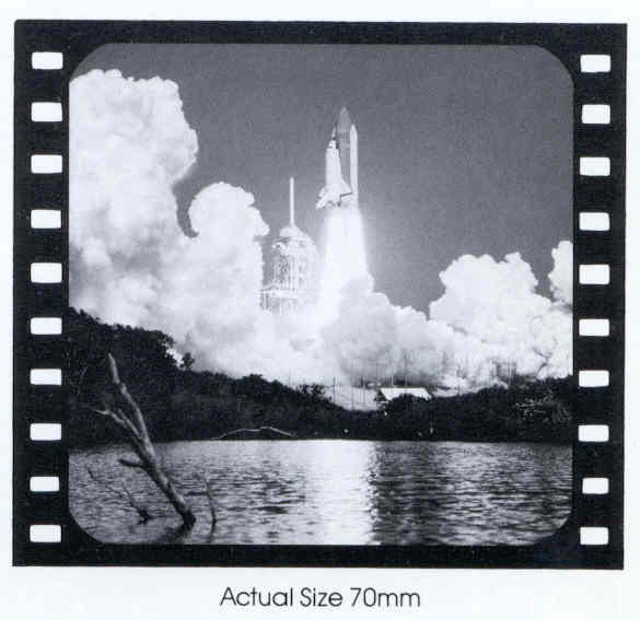

In addition to Mitchell’s large format camera, there were10 Photo-Sonics 70mm-10A high speed cameras. They pulled down 10 perforations for each frame of film, yielding a square image. (see photo below) This 135lb, pin-registered camera could shoot at up to 80 fps. The massive motor operated on 208V 3-phase AC and a gearbox setting controlled the frame rate. Many of the lenses were made by RTH (Rank-Taylor-Hobson) which later became Cooke Optics from England.
Interesting Note: Philip Kiel, president of Photo-Sonics Inc. told me that in 1986, the iconic hi-res, color telephoto shots of the Space Shuttle Challenger exploding were shot on a Photo-Sonics 10-A that was built in 1959.
Joseph Przyborski sets up a 70mm Photo Sonics camera at Cape Kennedy
10 perf pull-down 70mm frame from Photo Sonics 10A
