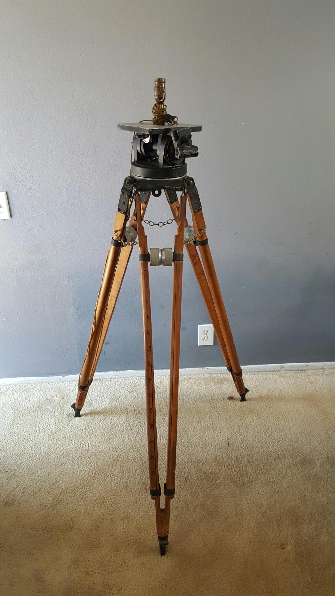

Post by Tiffany » Sun Aug 14, 2016 7:02 pm
Hello Mark!

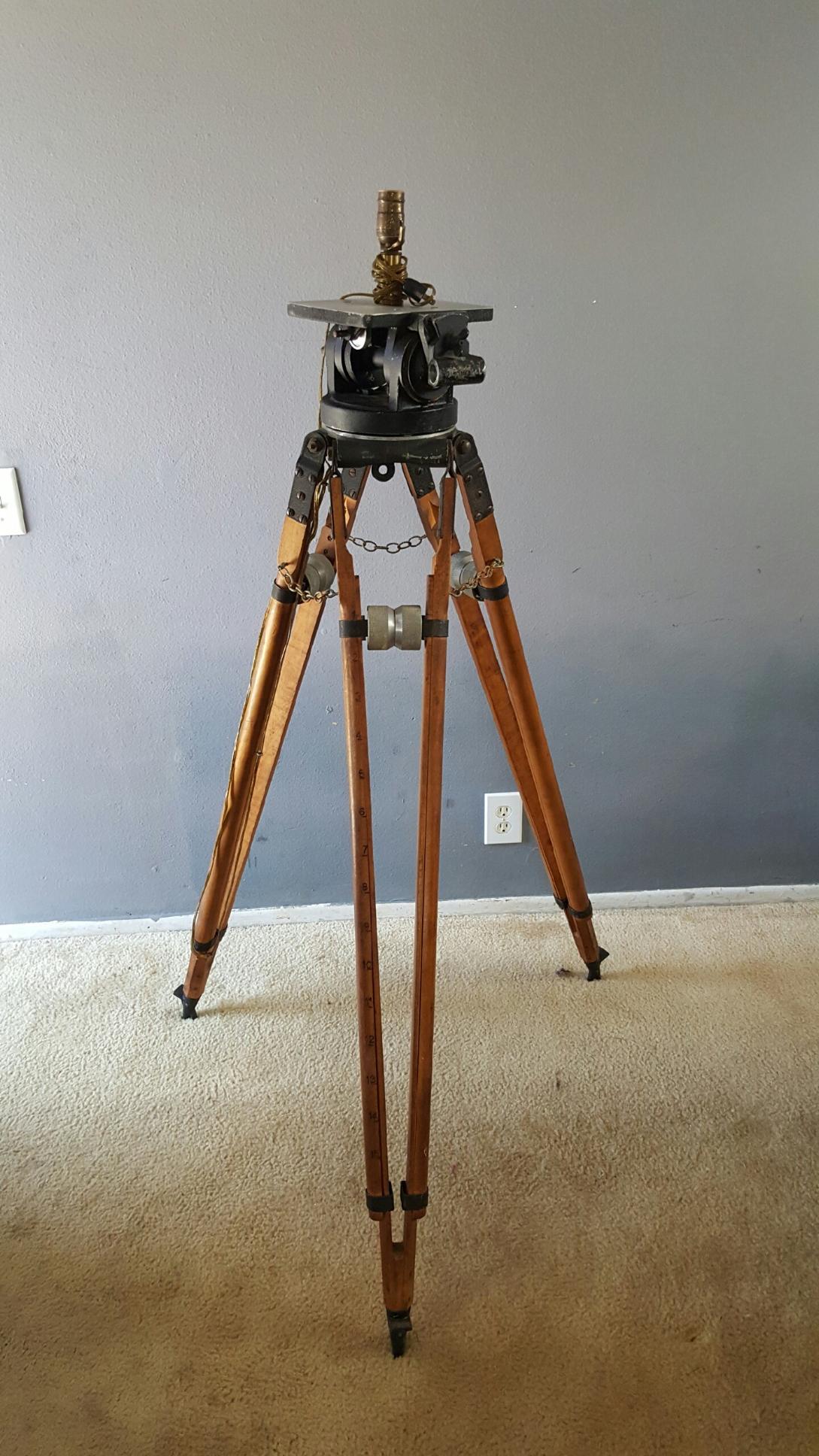

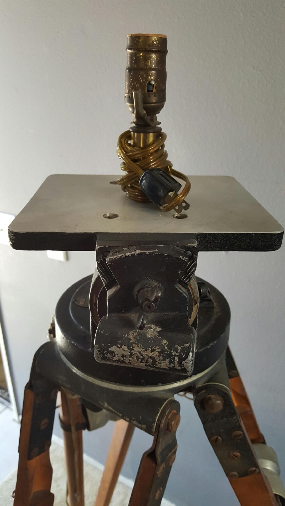

I have recently gained ownership of a Mitchell Camera tripod and am trying to research/appraise it. Can you help me, please? Here are some pictures I took. It looks like someone converted it to a lamp, not sure what that would do to the authenticity. Any information or guidance is greatly appreciated! Thank you!!

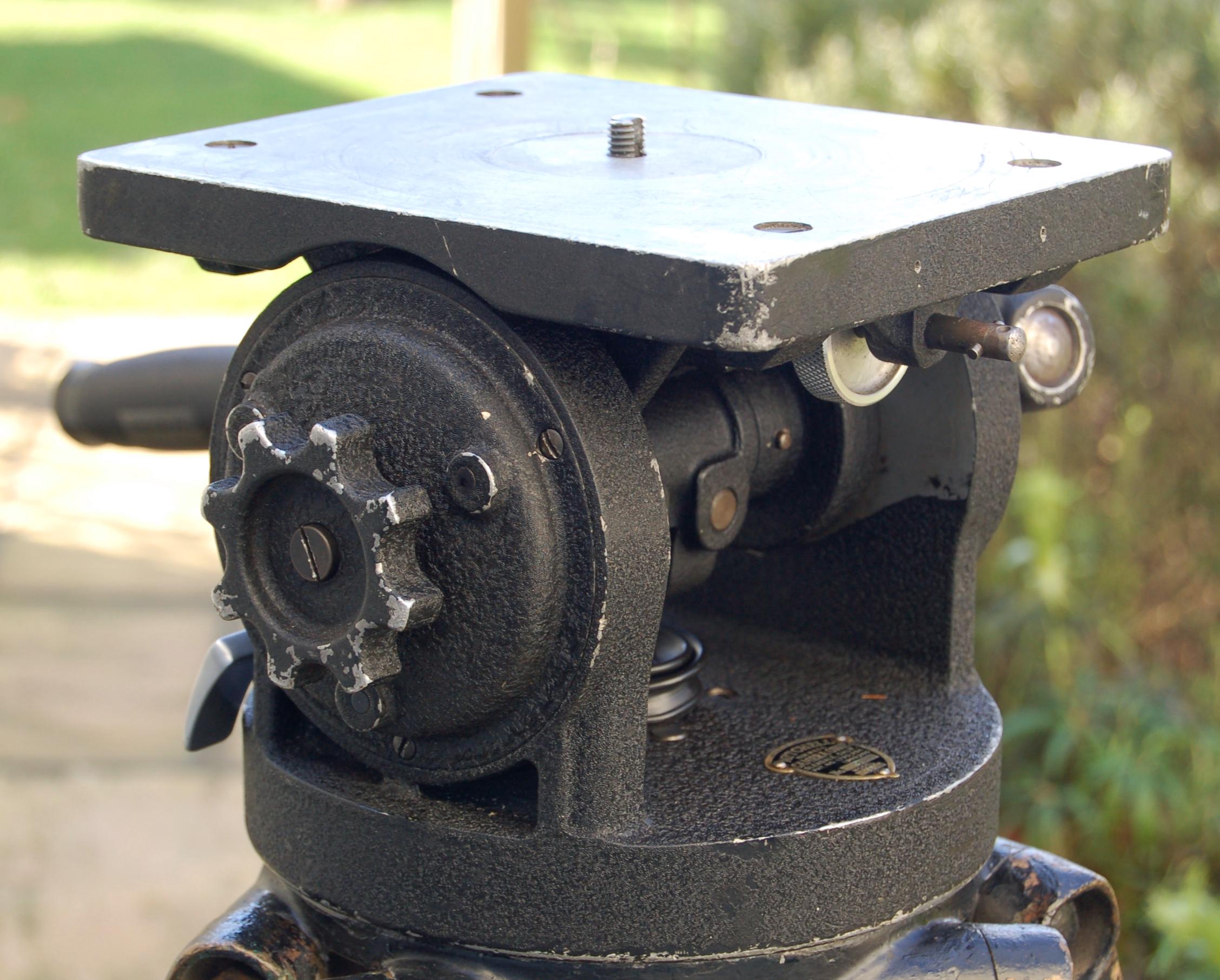

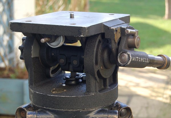

Hello Tiffany See pictures of my Mitchell BB s/n #91. This is a lot later than your early model of course. However, I've sent the pictures to show the central spigot thread which I hope your tripod still has? Scrap instantly the 'light' fitting. Ug!

Post by mediaed » Tue Aug 16, 2016 5:48 pm
Tiffany,
Yes, please get that light off. As to price guidelines, the best possible would be with the pan/tilt handle and a Mitchell badge on the wood tripod.
Current and past sales put a value of between $600 & $800. There is one currently on E-bay for $1300 that has all the essentials. No badge on the wood "sticks" would lower that estimate.
Your piece looks to be in quite good condition for the age.
Post by marop » Tue Aug 16, 2016 8:52 pm
Hello Tiffany,

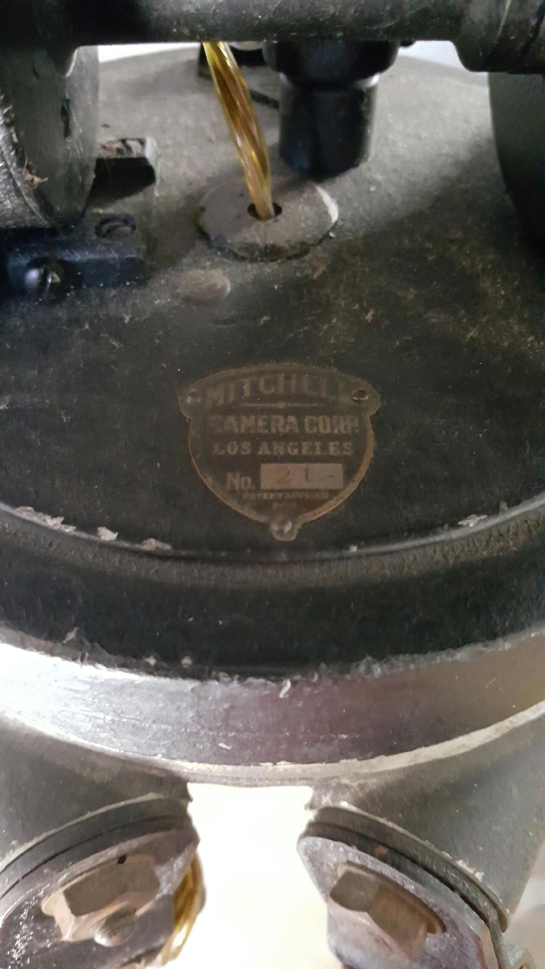

Very nice tripod. It looks like it could be one of the first made; it has the earliest Mitchell Factory location (Los Angeles) and it is an extremely low serial number, it is no. 21?. It has the earlier style leg locking knobs as well. History on tripods is not very likely, however there may be clues on the head or legs...but they also may have been erased or worn away. I own an early head as well and in closely inspecting it I found 3 stamped letters, UPC, which I believe may be Universal Pictures Company. That name was adopted in the 1920s, which is consistent with the vintage of the tripod.
Is there a logo on the tripod legs? The Mitchell sales records I have do not list tripods, however if this really is the 21st tripod made, I could let you know who some of the early buyers of the cameras were. It would be fun to speculate which of them may have own it. I would say it is possible that it as sold with Mitchell Standard no. 21, but of course there were many tripods sold that would not correspond to the camera as it would only take on buyer purchasing 2 tripods or one buyer not purchasing one to throw off the numbering...but again, worth the fun in speculating. However if ther are any clues, marks, initials, etc., you never know.
As to value, it is a tough one. A friend just sold a set of legs only for $225. His set of legs did not have an acorn ID tag. The eBay sales are obviously helpful as well but you never know with eBay how the next sale will go. On the plus side, your tripod is extremely early and would command a higher price to the person that wants the earlier tripod to go with an early camera.
Hope this helps.

Post by Cinevision » Thu Aug 18, 2016 12:48 am
Hello Tiffany,
If you can establish a value for your tripod, I would be very interested in it, as I am currently restoring an earlier Mitchell camera, and your tripod would be about just right to go with it.
Let me know.
