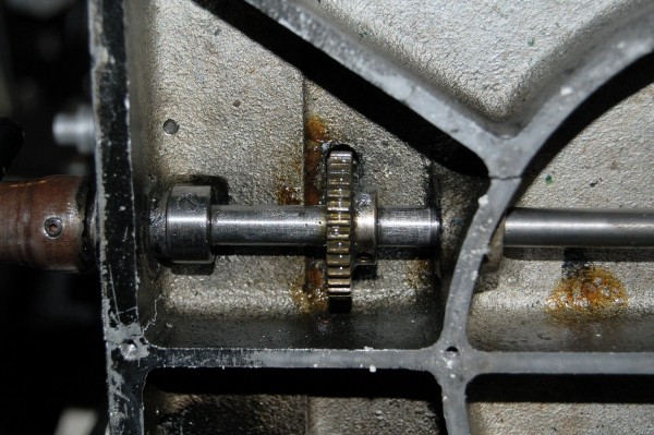

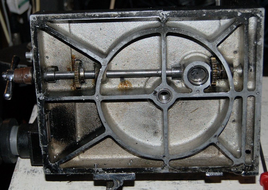

Post by lilybettina1 » Sun Mar 05, 2017 9:34 am
So why doesn't my Standard Mitchell #146 rack fully across? A cracked base.. At some time the poor thing had been dropped on it's back corner bending it upwards and thus the camera body sticks half way across. Oh well, the camera it still looks fine even if I can't critical focus. A repair job would probably fix the problem, but that can wait for another day.

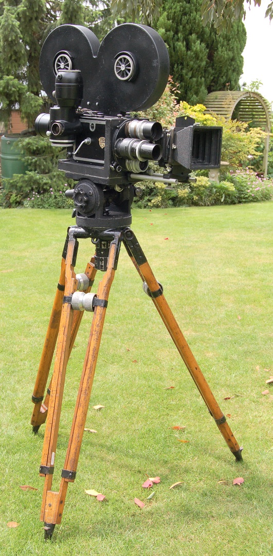

Post by lilybettina1 » Tue Mar 07, 2017 1:19 am
Hello Mark, first owner was RCA/RKO 1928, but it's been through a few owners since that date and converted in the UK to animation (but it still has it's iris wheel and matte panels). I've since restored the camera back to it's original 'look' , apart from the rack over.

Post by marop » Tue Mar 07, 2017 8:35 am
Great looking camera! Thanks for sharing the photo. A lot of the cameras were converted. In the case of BNCs, a lot of the main part of the camera, the main housing of the movement, went overseas, I think mostly Japan, for animation. Also the Cinema Products company used a lot of the same part of the Mitchell's to make their own Blimp Camera. I read one guys comment on a this blog that he was amazed that these machines survived. I have a Bell & Howell camera that was last used in the 1990's for rotoscoping. Amazing!

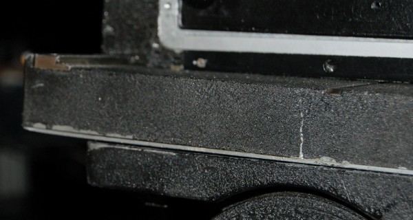

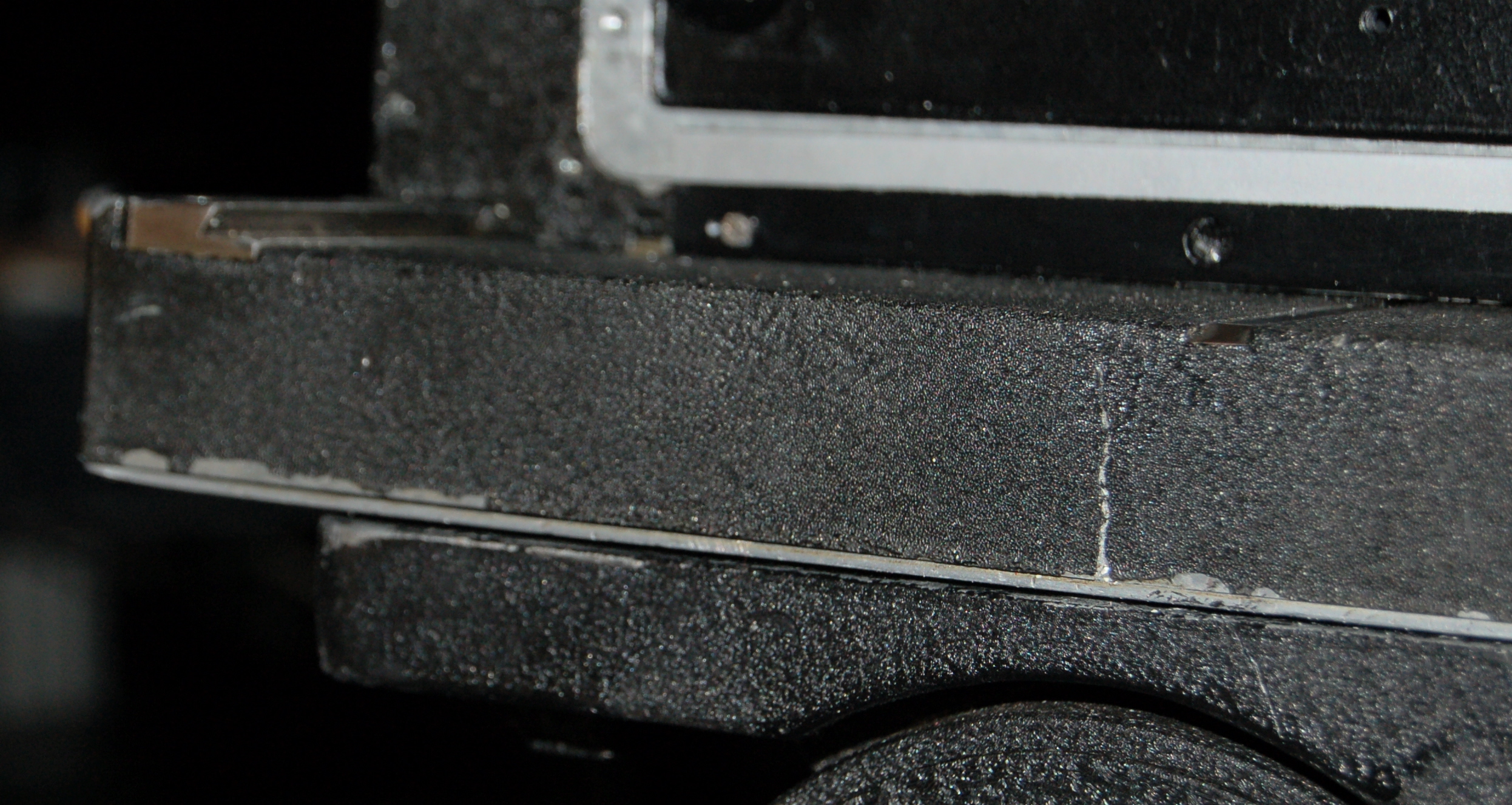

Post by lilybettina1 » Sat Mar 18, 2017 2:22 am
The cracks can be seen clearly here, around the circle at 12 o'clock ten o'clock and across at 9 o'clock on the edge. Note the serial number 146. This is an early Standard Mitchell.
